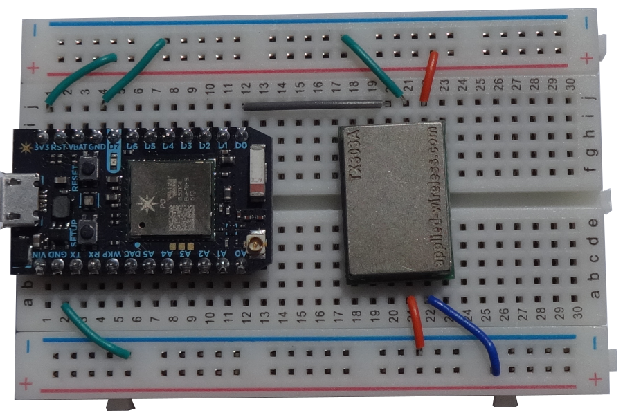

In the back of this remote are dip switches which sets which fan I control. So with this in mind, I knew if I tapped into one of the remotes and control the dip switches, then I could control the entire houses fans. …
With this new version it's really simple for anyone to get started and control your regular ceiling fans from your smartphones/tablets/computers without spending a lot of money.
The hardware exists of a breadboard, Photon, transmitter and some wires which costs less than 50$
Then you install a universal fan remote kit from Amazon which can be purchased for about 25$. You will need 1 per fan you want to control.
Next you use the FanRemote.IO service to control your fans remotely , schedule them , or integrate them with your Nest Thermostat .

@Carsten4207 , you don’t mention the source of the transmit module anywhere. Can you specify?
Its in the Hackster BOM as ‘Data Transmit Module’. But dead link. Thanks for pointing it out.
Looks like they dont list them anymore. Which is not good. The entire project depends on it. I’ve emailed them to see whats up.

They have the transmitter listed on their site again. Was just out of stock for a bit.
