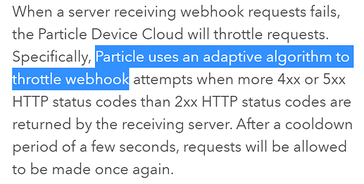

This should give you some initial info about that
https://docs.particle.io/reference/device-cloud/webhooks/#limits

Hi @stofmike! Sorry indeed for the long delay (and thanks @ScruffR for setting expectations accordingly :slight_smile: ). The ETIMEDOUT window was increased to 20 seconds in 2018.
