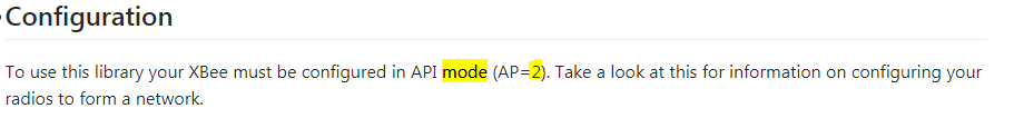

Your XBee's need to be configured to API Mode 2.
That is specific to the XBee Library. It's in the docs:
