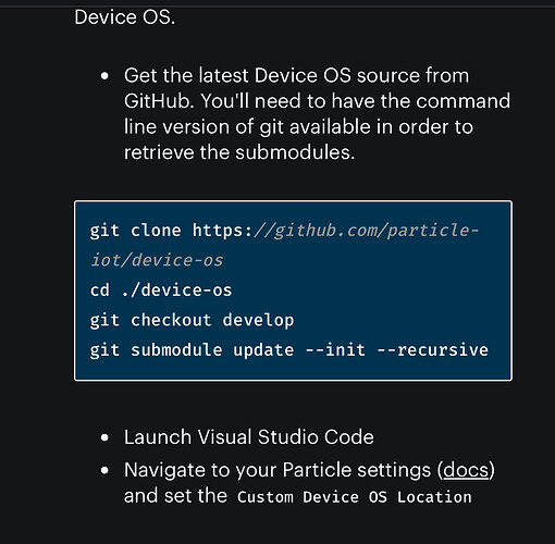

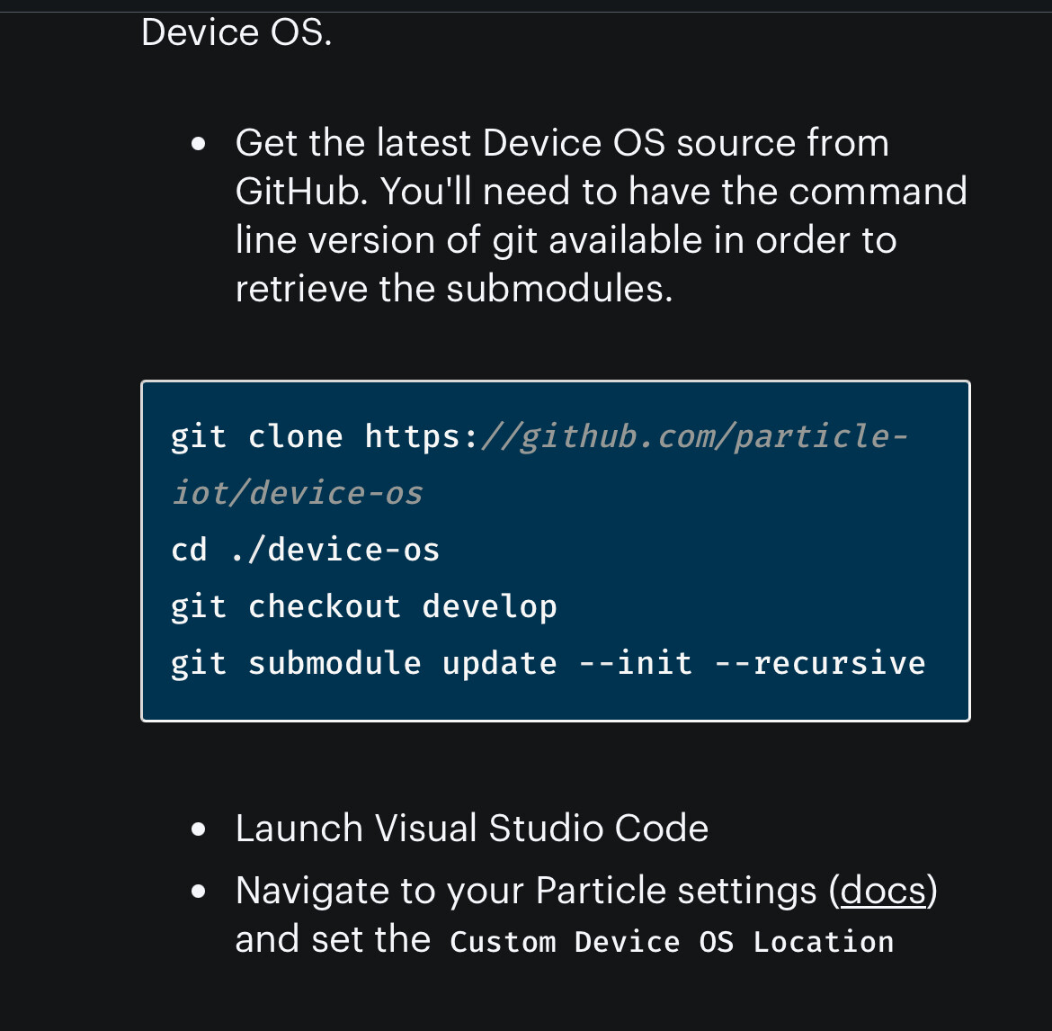

This is the procedure I followed for my custom OS.
I don’t think me redoing that will change anything since I didn’t specify any particular build and it did give the latest pre release 6.3.0

  2. I did the git clone procedure as per above screen shot
