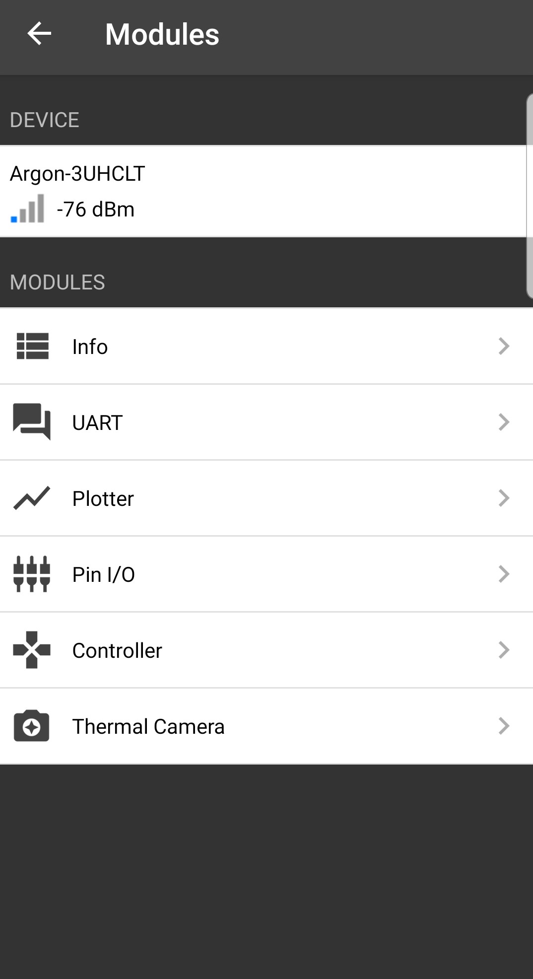

I flashed the the bootloader “argon-bootloader@1.2.1.bin” to my Argon and compiled and flashed via CLI like @rickkas7 demonstrated.
On Bluefruit the Argon does not display as though it is UART capable, but when I connect on my Samsung S8 UART service is exposed.
Messages do transmit from the Argon and display in the app, but only on the Android. The iPhone 7 I am using for testing does not have the UART services exposed.

Just FYI, except those mobile Apps you mentioned above, there is an App named “LightBlue” which is more reliable and universal for testing BLE functionalities. No matter how you build that BLE UART serial library from Workbench or cloud, you can verify if the UART service is successfully added or not by using this mobile App to connect the BLE device.
The Argon reset issue after disconnection is most likely fixed by this way: BLE Peripheral UART Streaming Assertion Failure.
Best regards,
Guohui
I did doubt it’s just a case of using another app (after already using multiple others) but I went ahead and downloaded “LightBlue” as well and what shall I, say the expected non-functioning behaviour manifests itself with that just the same.
If you wish I can send you the cloud built binary to check yourself (the build run was just a few minutes ago, if you want to look at the logs).
(click to view full image - service gets advertised but is not present in the GATT service list)
From the image, I can see the UART service UUID is correct and is appended to advertising data successfully, but the UUID of the added UART service is incorrect. There must be something wrong when adding the UART service and characteristics.
Yup, but not on the code side as the exact same code works just fine when building locally.
