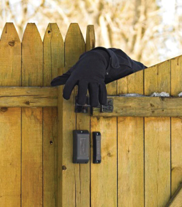

I would like to sense when an electric gate is closed:
and was looking for something like this:
Honeywell 5816od
