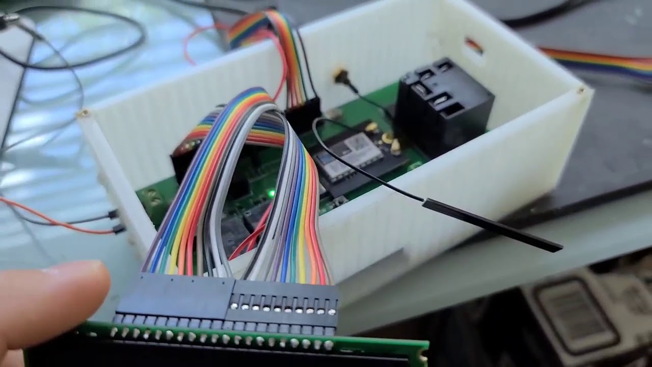

I’m running into a situation where there is a halt condition on boot while the B402 is trying to connect to the particle cloud on boot. This causes the OLED screen and joystick to not work while the OS is trying to connect. I have attached a video of the issue for reference. Is this typical behavior? Does anyone know of a possible workaround to the issue?
I guess you are running default SYSTEM_MODE(AUTOMATIC) and also not using SYSTEM_THREAD(ENABLED) if so, then the behaviour you see is expected.

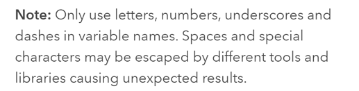

You should not have blanks in your variable names
https://docs.particle.io/reference/device-os/firmware/boron/#particle-variable-
