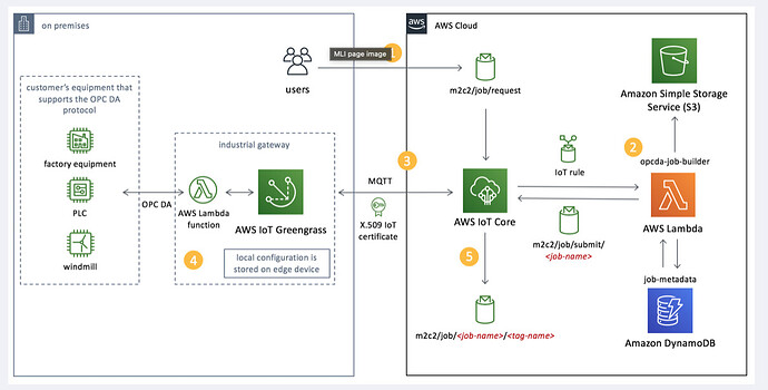

Another popular choice is AWS Greengrass which is coupled with their IOT services. In my exerpience, the solutions are more flexible but may require more expertise and configuration on your end.
