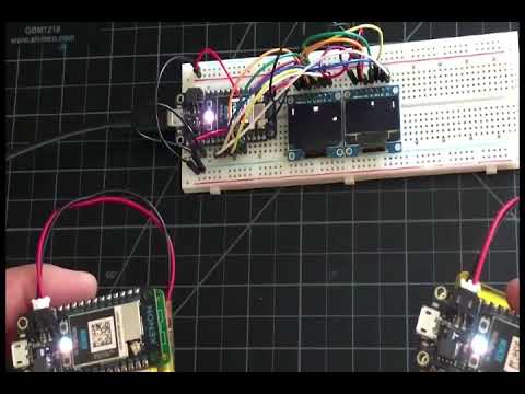

You can’t connect a HDMI screen to a Photon, and the LCD and OLED displays that connect via SPI or I2C are both expensive in larger sizes and have too low of a refresh rate for anything but the most basic of games. I did a really slow version of pong with two SSD1306 displays, but you can’t get much more than that.

The most cost-effective solution for the Photon is an SSD1306 OLED display. It’s tiny, less than an inch, but it’s cheap and works well. For the best refresh rate, get one with an SPI interface, but I2C works as well. For extra fun, you can use two SPI SSD1306 displays.
Using an Argon with two SPI SSD1306 displays, and two Xenons with IMUs communicating by BLE to control the paddles in a pong game.
