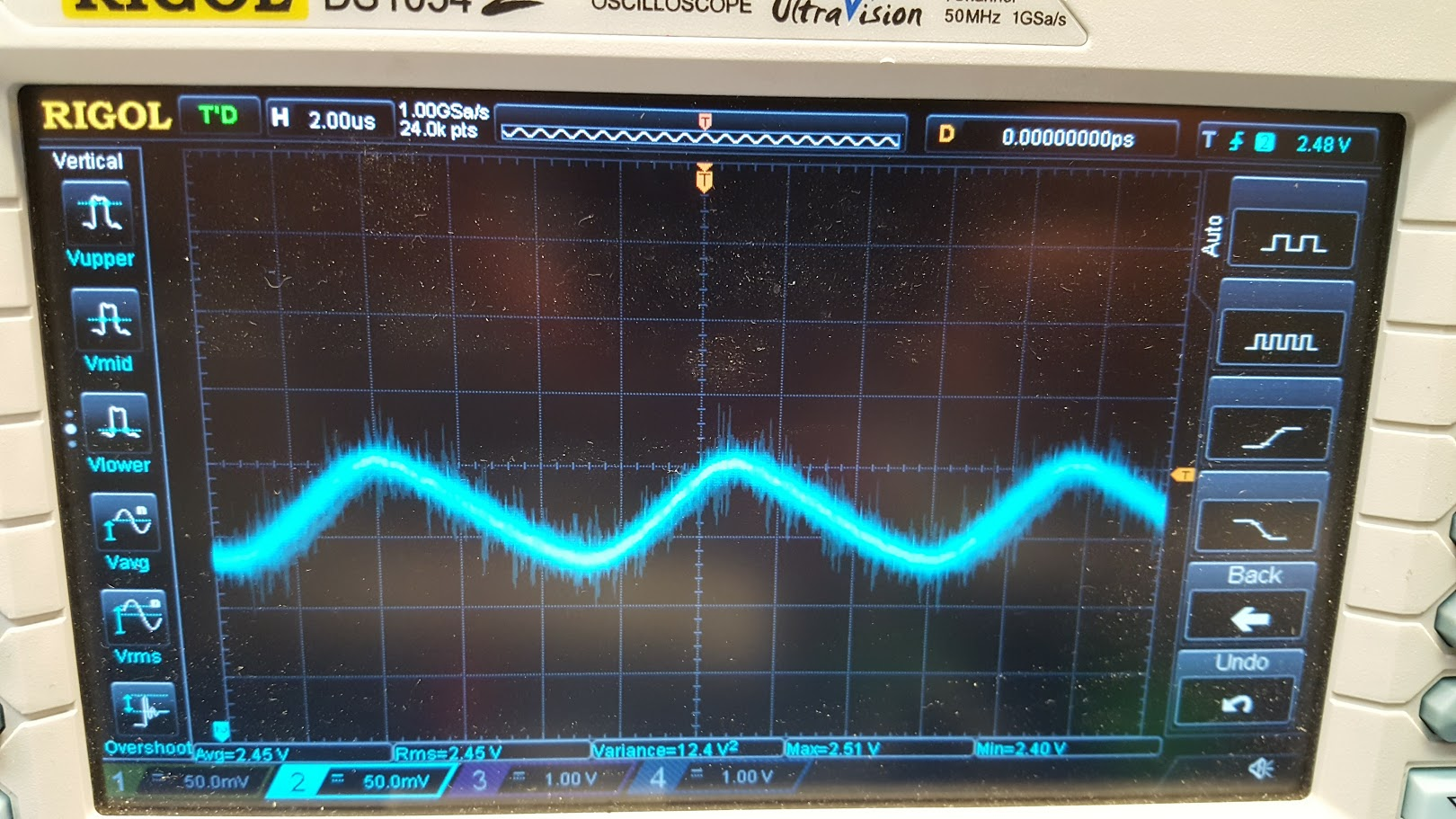

The Photon is obviously much more precise at reading than the Arduino (but the precision causes headaches). Hooking it up to oscilloscope I can see that the A1 voltage reads from 2.40V to 2.51V. Now the Arduino seems to be great at flat lining that to one value (2.42V) even when I only do a single read. But the Photon seems to read it ‘too’ precisely capturing different points in the voltage variation.
