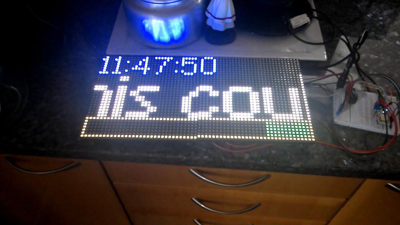

@peekay123 , @ScruffR, I just wondered, with the optimised library do you think a core could run one 32x32 display or more?
Has anyone had two displays side by side and linked to give say a 16 x 64 or a 64 x 32 display? (and then scrolled text across both of them?)
As said already - one 32x32 panel with or two 32x32 without double buffering is no problem.
Or four 32x16 panels would give you a 128x16 scroll text display

Given the experiance I’ve made with my two panels, the video cube should be possible with no real tweaking, since it seems to show the same picture on all six faces, so you provide one pic from the Core and this gets forwarded through to all daisy chained panels. You just need to supply enough power (5V x 2A per panel = 60W).
This at least worked for two panels that way.
The video wall is a different kettle of fish, since you need to provide a different pic for each panel, for which the Core has not enough RAM.
The Photon will allow more panels, but then speed might become an issue.

And as mentioned in one of my earlier posts, I have squeezed a teeny-weeny bit of speed out of your RGBmatrixPanel lib by remapping the R1, G1, B1, R2, G2, B2 pins to the low byte of GPIOA.
I have not timed it yet, tho’.
And I haven’t gone the ASM route yet either.
@ScruffR, video is video dude! I think you are talking about animation. Nonetheless your point is valid. BTW, I posted the optimized RGB pin library last week. I find that it add 30-50% improvement in frame rate!
What I would love to see is FastLed for the Core/Photon where you could do some serious animation on “smart” LEDs like neopixels. I posted a message on the authors github to see if the Spark Community could help move the port along. :smile:
I’d like to see that, too.
And yes, I was a bit flimsy in using the term “video” - I repent in sackcloth and ashes :wink:
And yes, I’ve built ontop of your lib from last week and think to have squeezed out a few CPU cycles per pixel again.
