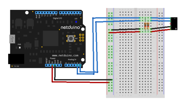

Pull-ups for i2c usually are 4.7KOm resistors between SDA and 5V and SCL and 5V
Found a pic for arduino http://forums.netduino.com/uploads/monthly_11_2011/post-12385-0-45058100-1322697185.png
