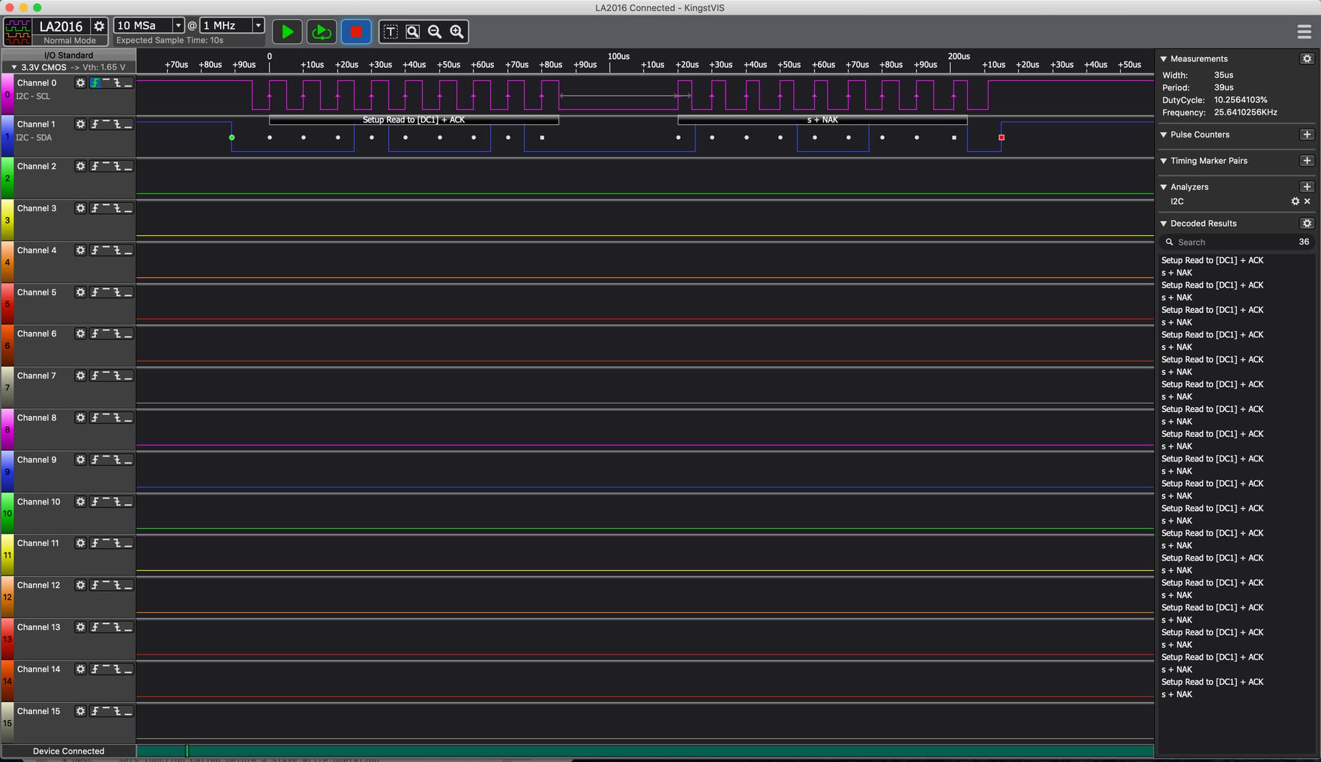

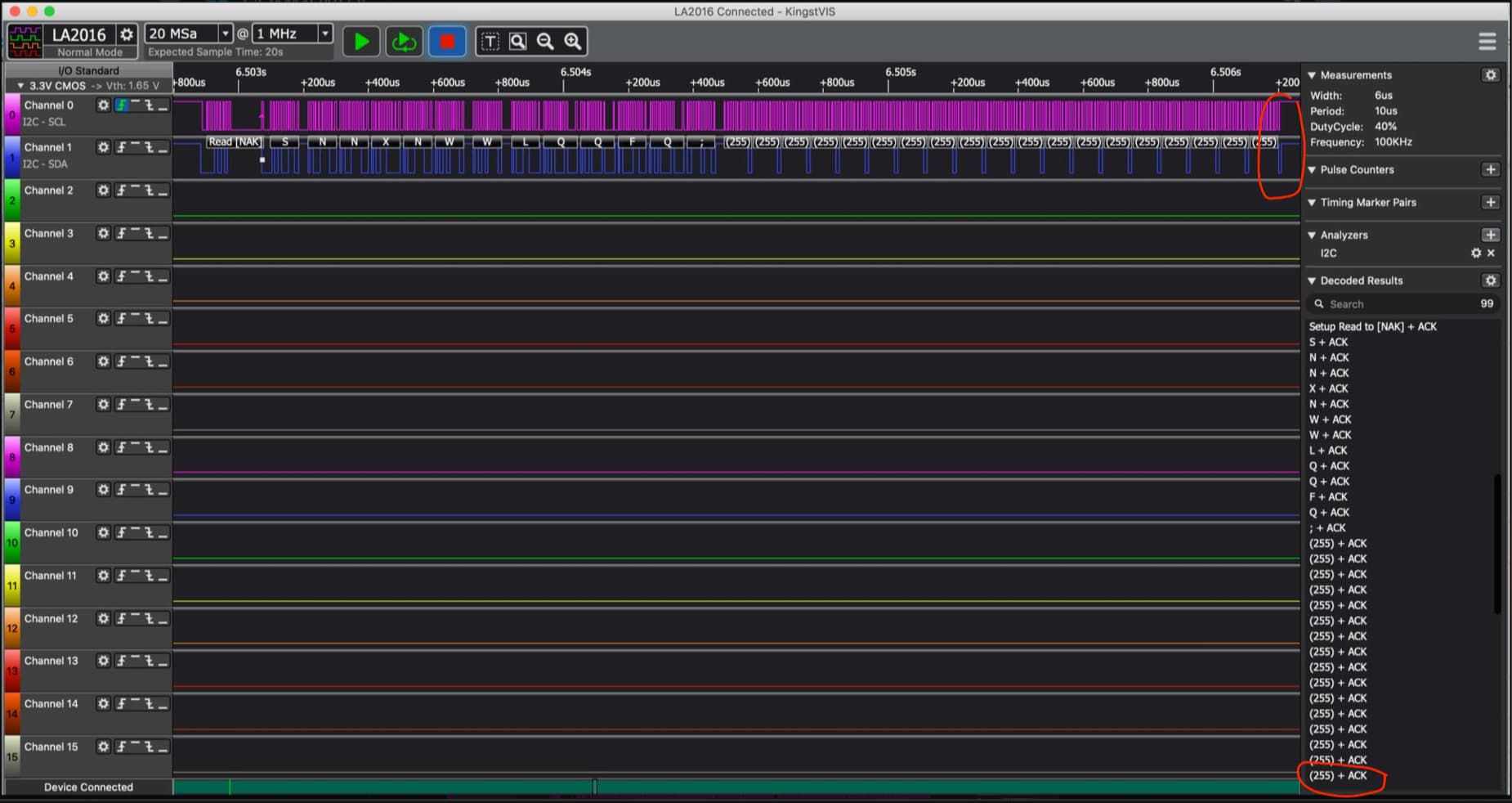

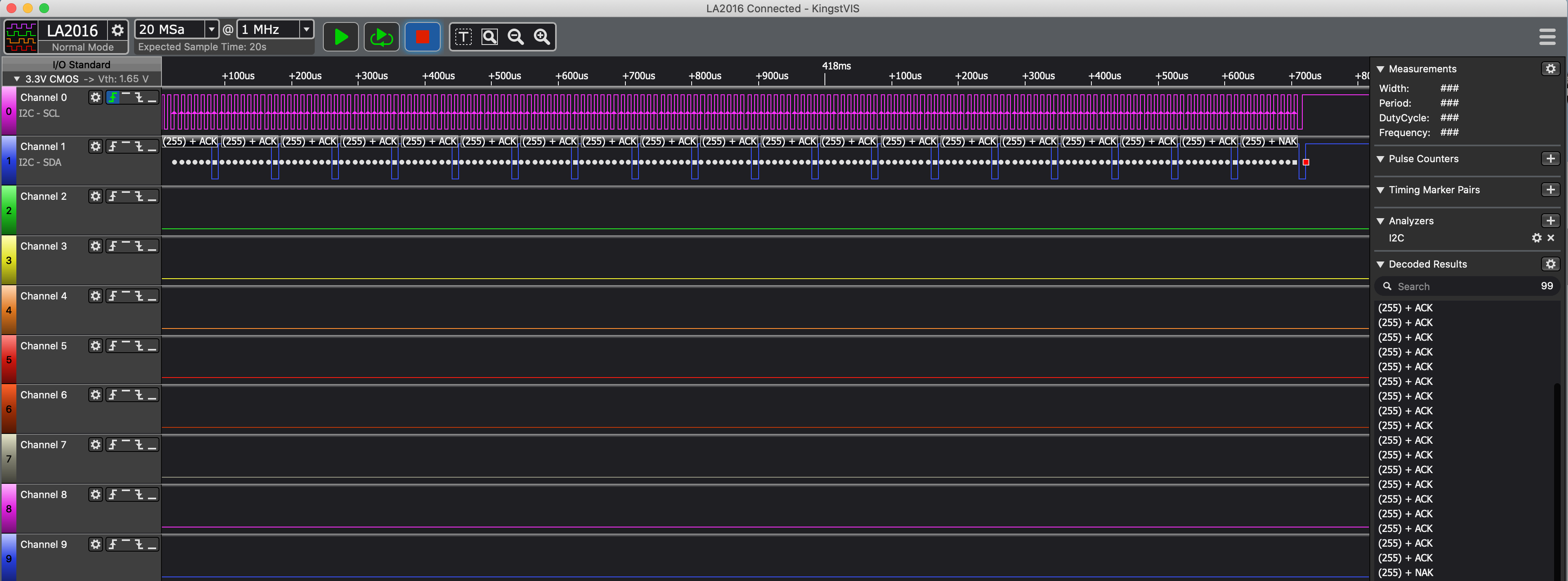

In case anyone has any further ideas, I've attached a few more logic captures of what I'm seeing currently.
For this test, I am attempting to use a Photon2 in a small project where I was using aPhoton before. I have a bidirectional logic level converter in place. With the Photon, I actually did not have pull up resistors on the 3.3V side. Only on the 5V side. (I'm still not 100% sure if they are supposed to be on both sides.) At any rate, I tested the Photon2 both ways with no difference in results.
The current test is just doing a Wire.requestFrom(10,32, false); (note I tested both with and without the false flag). As the slave, there is an ATTiny85 that is running at 5V and has been programmed to respond to a request with 32 bytes of data. It will be a serial number and then just filler for the remaining bytes.
This works just fine with the Photon and with an Arduino as the master.
Here is a logic capture when using the Photon that does exactly what is expected every time:

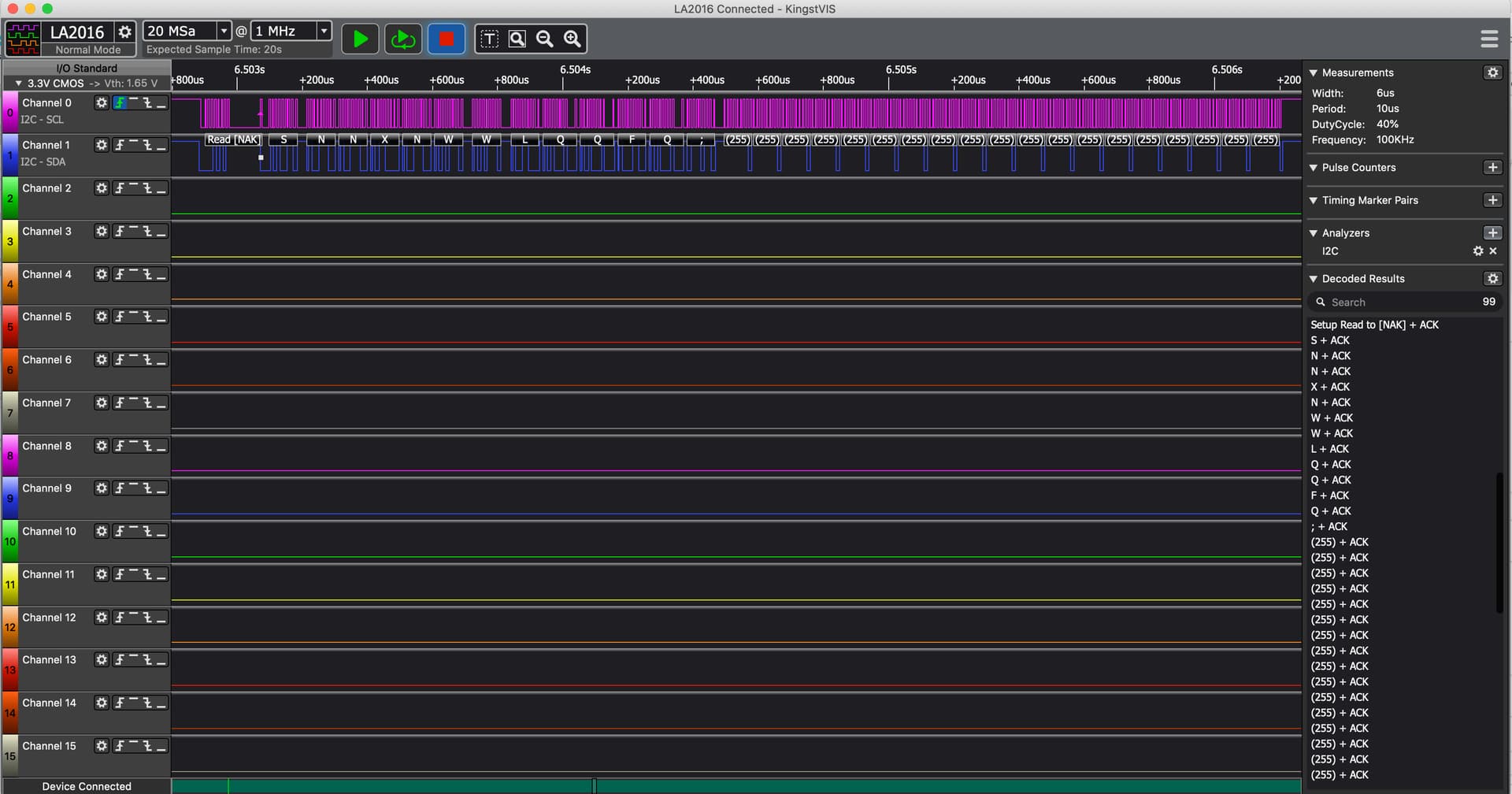

When I use a Photon2 in place of the Photon, I see the below results.

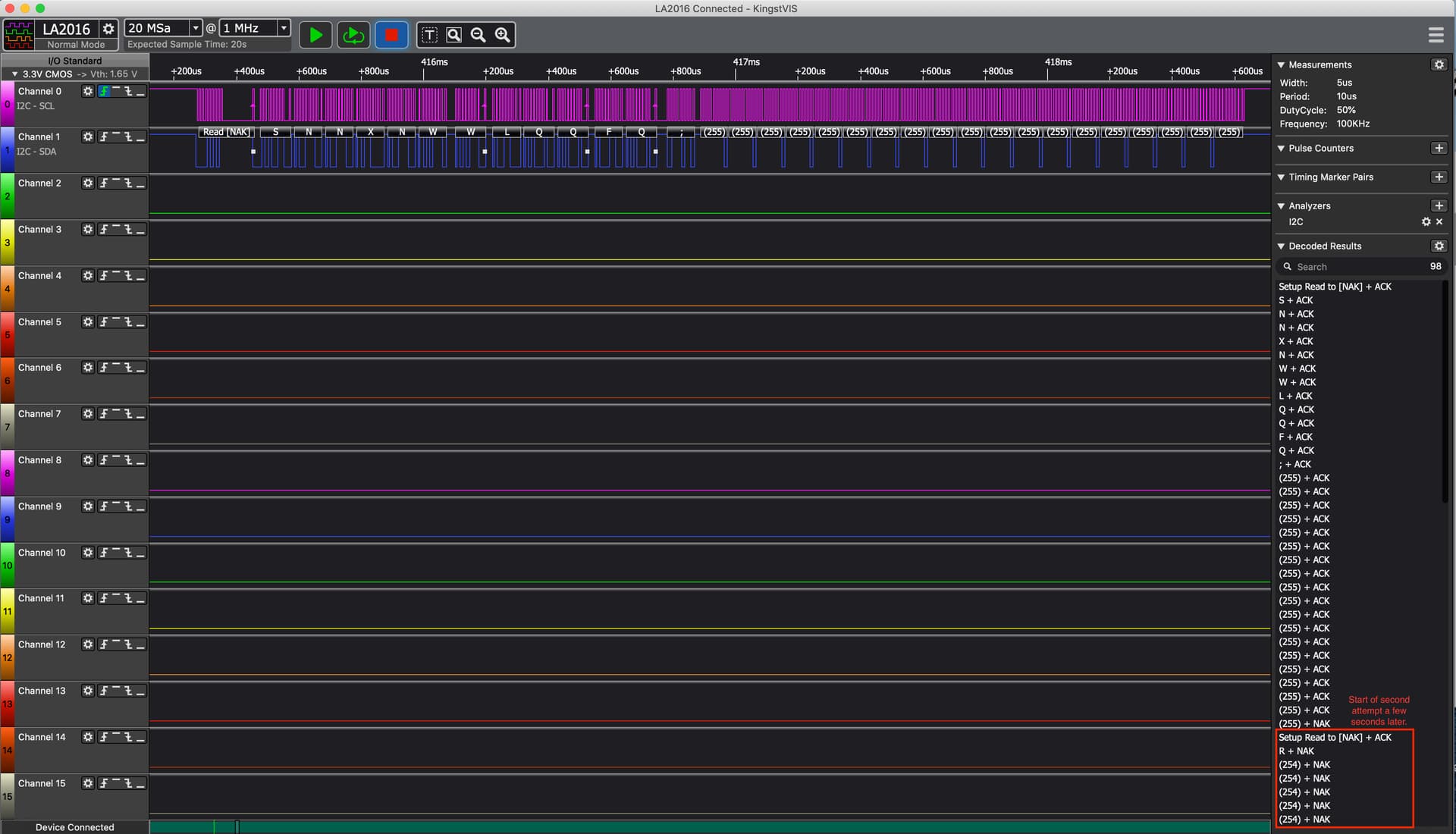

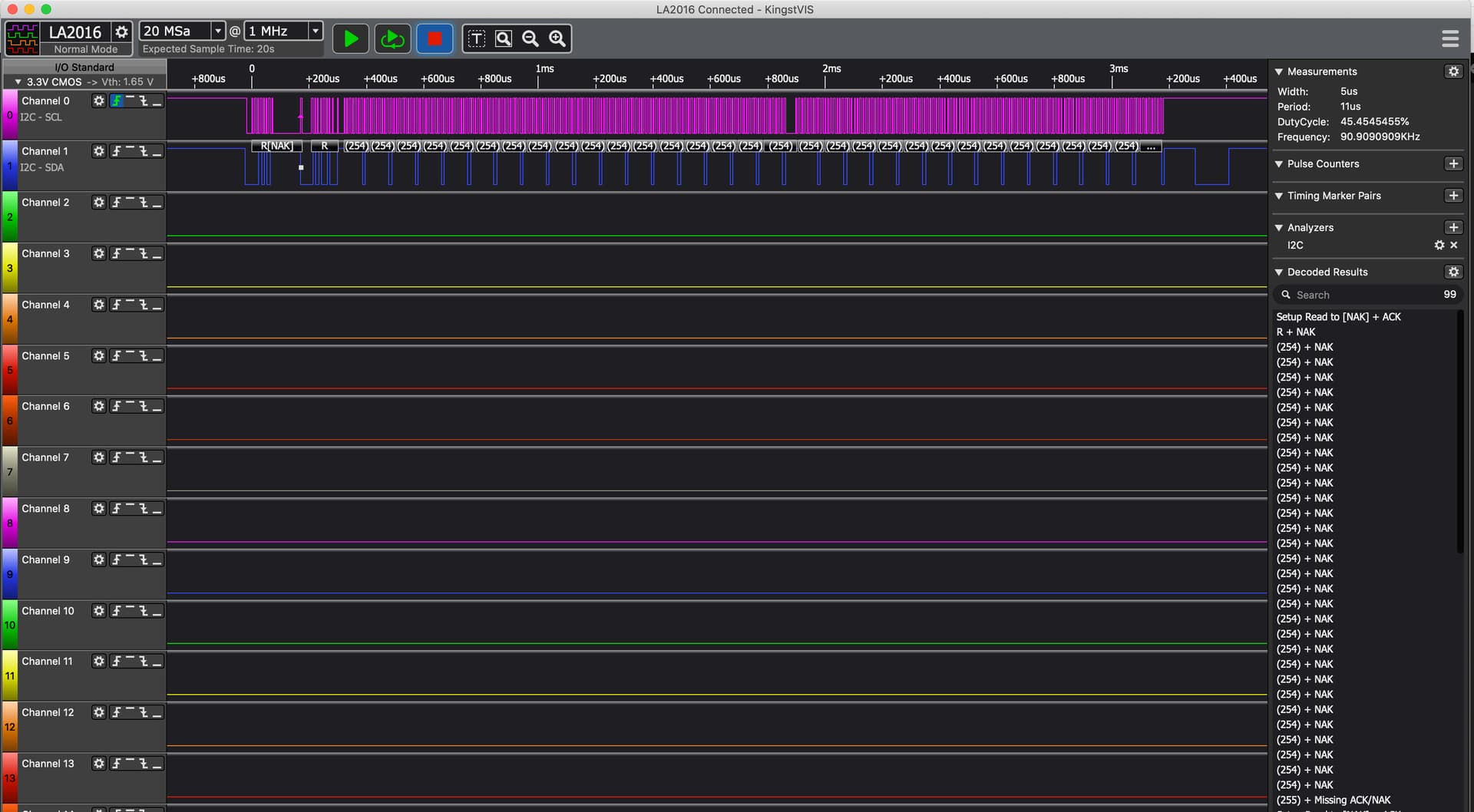

And then in a subsequent test, you can see in the next capture that I actually got the correct thing back once, but then on the next try a few seconds later, it failed in the same way as before.
I feel confident something is wrong in the way the Photon2 is handling i2c communications at this point.

@jones_corey apologies, I failed to set this thread to watching so I didn't get updated on your latest reply (I have it set to watching now). Sorry to hear you are still seeing issues and I am wanting to see this through to resolution.
There may be something within deviceOS that is handling the I2C peripheral differently photon 2 VS photon, but it will be hard to diagnose without a live session or without reproducing on my end. However, with your latest logic captures, I see some undesired behavior even in the photon capture that I suspect is the root cause for the issue (last byte of read is ACK'd when it should be NACK'd).
This behavior is different than the captures you shared previously and the client will be outputting data on the next falling edge of SCL. If the next bit to be read is a '0' you run into bus contention thus corrupting the next transaction, but if it is a '1' the host may be able to send a start condition to reset the client. I'll also note this behavior is not seen in the photon 2 captures so something has to be different.
Can you provide the source code for these latest captures (Host and Client)? I and/or engineering are wanting to reproduce this setup on our end so that we can perform additional testing. Also, even if you don't see a difference in behavior, best practice to have pull ups on both sides of the level translator. Again sorry for the poor experience, I am confident we can get this issue resolved!

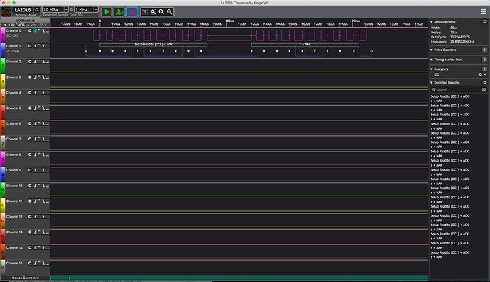

My apologies @erik.fasnacht, that screenshot is actually not including all of the bytes when connected to the Photon. I had not expanded the window when I took that screenshot. I've included a new screenshot below showing just the end. The last byte from my client does actually have a NAK, not an ACK. I thought that screenshot being cut off might cause a problem when I included it... :upside_down_face:
The below screenshot shows just the end when the Photon is being used and the last byte is always followed by a NAK.
I've got to admit things have changed today, and I'm not entirely sure why. When I went back to capture that previous screenshot, I decided to hook up the Photon2 again with an Arduino nano as the client (logic level converter and 4.7Kohm pull ups on SDA and SCL on both sides) and it appeared everything was working correctly. Including whether or not the third flag in the Wire.requestFrom() call was set to true or false. This is entirely different behavior than I was seeing last week.

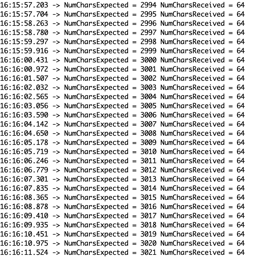

Hooked them together. Three wires between them. SCL, SDA, and GND. Put 4.7K pull up resistors on SCL and SDA to 3.3V. No level shifter of course. We would expect this to send a request for one byte, read one byte and increment the counter.
But we get the following in the serial output after it's been running for a while (it's only received 64 bytes after requesting the data over 3000 times):

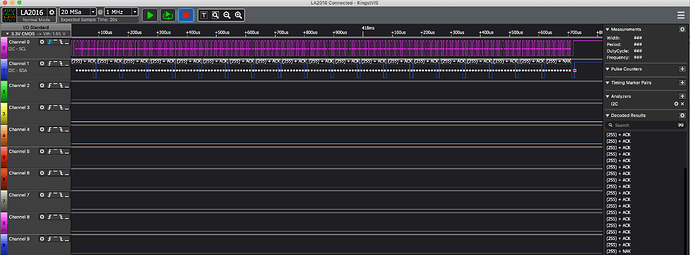

The logic capture of this looks like:
So at this point, I don't know exactly what to believe. :slight_smile: It looks like possibly with a change in the Library I was using on the ATTiny85, today I am able to get the results I'd expect.

On the drive home, it occurred to me. Changing the library made the logic captures all look nice. The ATTiny sends back the data correctly every time now, but in all of the testing for my last post, I never once actually verified that the Photon2 was reading back the data. Which was the original problem to begin with… I had focused too much on the fact the logic captures were weird…
Once I put the Photon2 back into my full code, I realized it’s doing the same thing as the Photon2 to Photon2 test is doing. The logic capture all looks normal, but the host Photon2 is still not getting the data.
So, the easiest way to recreate the issue is by just hooking two Photon2s together using the test code from my last post.
