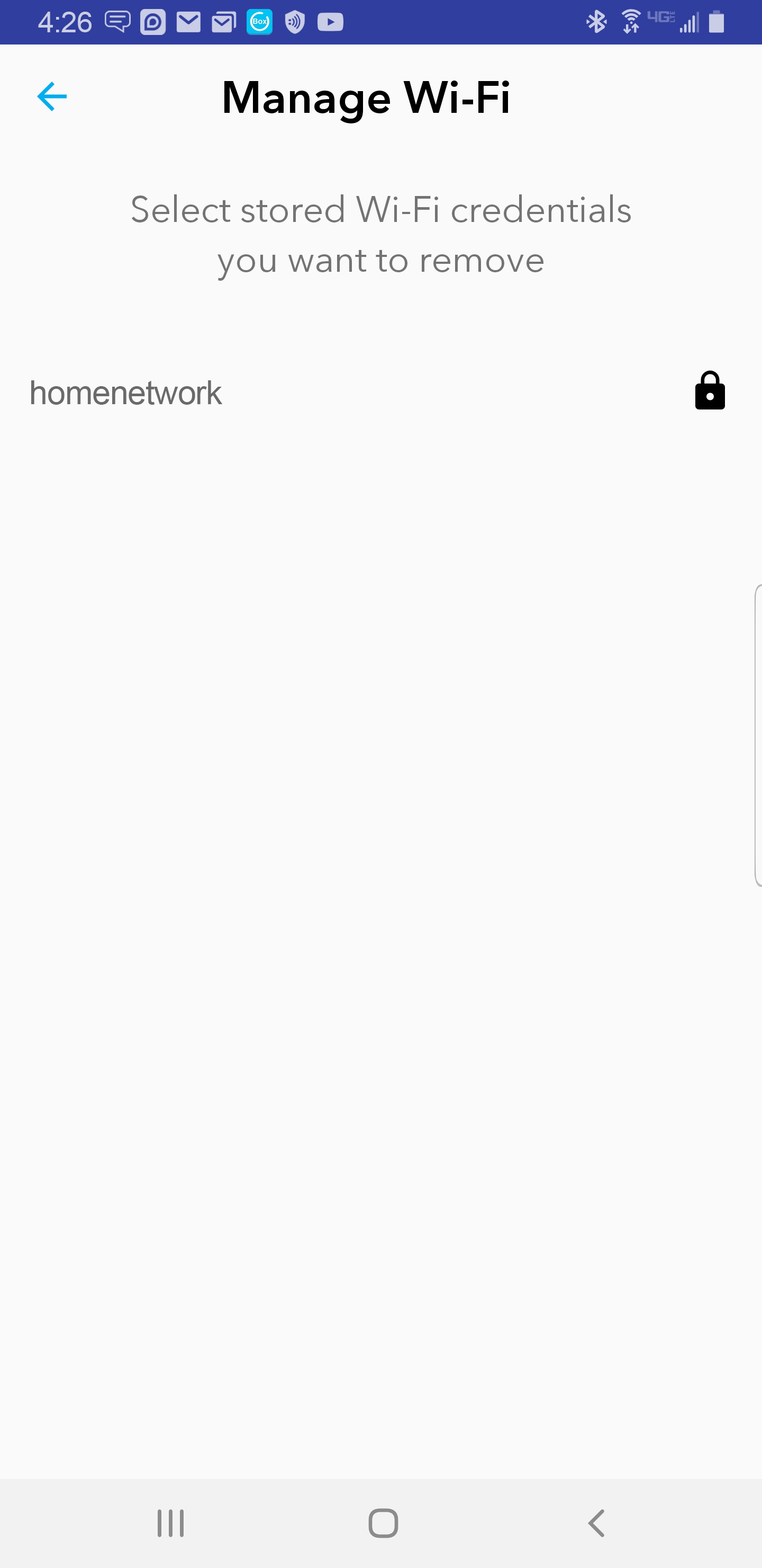

after clearing credentials, if I go look at what is stored on the device I have seen network both locked and unlocked, but never empty unless I choose to delete it in the Particle app:
I have tried every combination of connection. Without enc, with enc, with enc & cypher, to no avail.

...mind you. this is the same network that this device was connected to, just a moment earlier. When I go into the particle app under settings=>WiFi=>manage WiFi for this device, it shows that the skynet is there, but it has a lock on it:
particle1
I clear it and reset WiFi parameters. Since your code has no delay (buffer zone) in clearing credentials (my fault, I should have added it), even after I use the Particle App to reset to WiFi credentials, upon reboot (device reboot), this code immediately wipes the credentials I just set, and now I am unable to flash anything to it.
