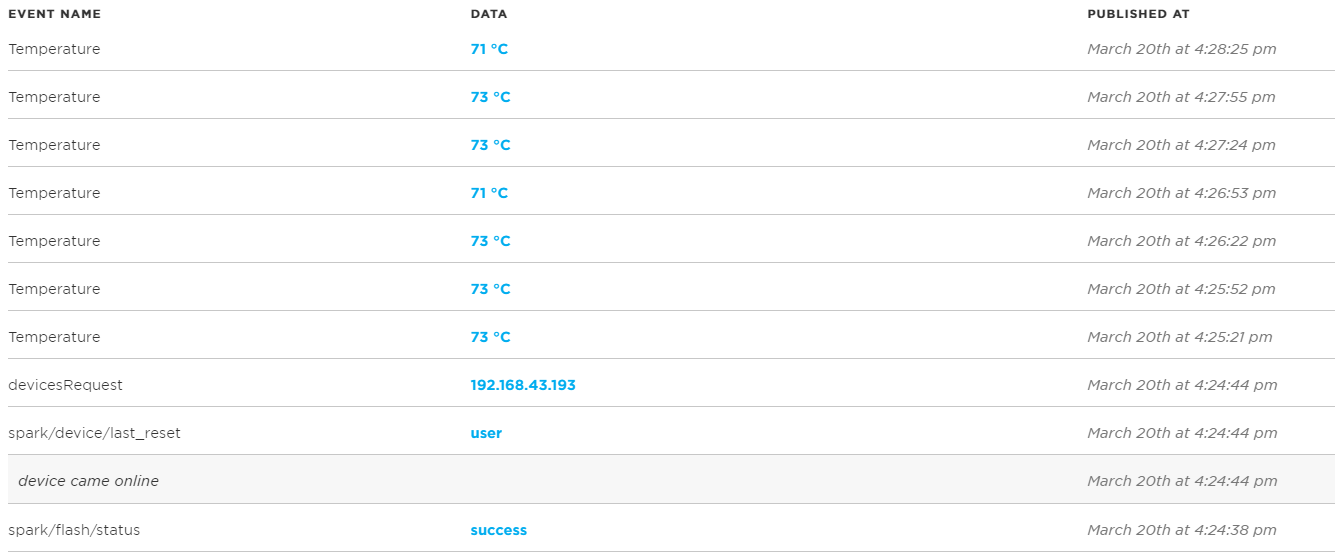

Local server in node.js example
Is there any output in the console of the webbrower?
@Moors7 yes there is, the value is constantly updated but no output on the web
I was thinking more along the lines of the developer console in your web browser, not the Particle Console :wink:
Try right-clicking and then selecting ‘inspect this page’. You should then see the developer tools with a tab for ‘console’. See if that has any output.
Hahaha…i see.
It seems like it failed.
Can you kindly help with that?
It appears these are two completely different subnets
Your first post mentions 192.168.43.xxx and the console complains about `192.168.137.xxx.
I guess that might be a point to start your search from :wink:

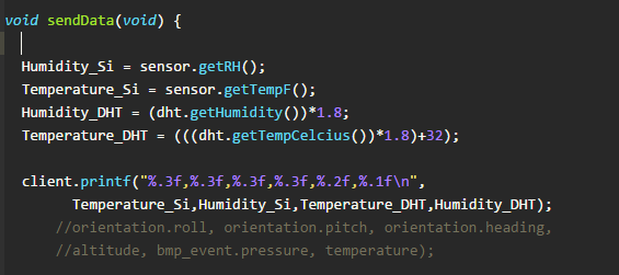

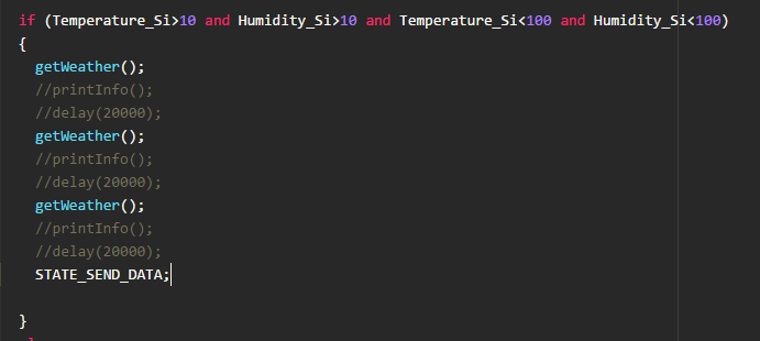

Above is my code>>> With this, I can view my sensor reading on dashboard and also be able to send data to my google spreadsheet script. But my goal is to get sensor data on my local server without going through cloud and display the data reading on simple web page. Thank you.
And how did you try to combine that with Rick’s code?
(Do try to use non-blocking delays)
Hi , Below is my code combined with Rick’s code. Now, I can complie and upload into my photon but im not receiving any data on localweb page, please help me to have a look and advise me.

void sendData(void) {
	// Called periodically when connected via TCP to the server to update data.
	// Unlike Particle.publish you can push a very large amount of data through this connection,
	// theoretically up to about 800 Kbytes/sec, but really you should probably shoot for something
	// lower than that, especially with the way connection is being served in the node.js server.
	// Taken from the Adafruit 10-DOF example code
	//sensors_event_t accel_event;
	//sensors_event_t mag_event;
	//sensors_event_t bmp_event;
	//sensors_vec_t   orientation;
	// Read the accelerometer and magnetometer
	//accel.getEvent(&accel_event);
	//mag.getEvent(&mag_event);
	// Use the new fusionGetOrientation function to merge accel/mag data
	//if (!dof.fusionGetOrientation(&accel_event, &mag_event, &orientation)) {
		// Failed to get data
		//return;
	// float orientation.roll
	// float orientation.pitch
	// float orientation.heading
	// Calculate the altitude using the barometric pressure sensor
	//bmp.getEvent(&bmp_event);
	//if (!bmp_event.pressure) {
		// Failed to get pressure
		//return;
	// Get ambient temperature in C
	//float temperature;
	//bmp.getTemperature(&temperature);
	//float altitude = bmp.pressureToAltitude(seaLevelPressure, bmp_event.pressure, temperature);
	// Use printf and manually added a \n here. The server code splits on LF only, and using println/
	// printlnf adds both a CR and LF. It's easier to parse with LF only, and it saves a byte when
	// transmitting.
	client.printf("%.3f,%.3f,%.3f,%.3f,%.2f,%.1f\n",
        Temperature,Humidity);
			//orientation.roll, orientation.pitch, orientation.heading,
			//altitude, bmp_event.pressure, temperature);
	// roll,pitch,heading,altitude,pressure,temperature

You should not call sendData() directly from your own code.
Rick’s FSM needs to perform the required tasks to set up the connectiin first by going through all the required individual states.
So your code should only “signal” STATE_SEND_DATA once your data has been collected and wait for state == STATE_REQUEST again before you collect the next set of data.
But to be sure, go back to Rick’s original code and try to follow through the flow and in your mind keep track of state on the individual iterations if the FSM in loop().

What about this?
Hi, do you mean this?? sorry, I am a very beginner.
Not really. Hence I also said this
You should look at the devicesHandler() function.
There you will find how STATE_CONNECT is triggered. The same would go for STATE_SEND_DATA
And I don't quite get the use of all the getWeather()/getWeather01() calls.
Just do each of them once like this
  static uint32_t msLastWeatherReport = 0;
  if (state == STATE_REQUEST && millis() - msLastWeatherReport > 10000) {
    msLastWeatherReport = millis();
    getWeather();
    getWeather01();
    state = STATE_SEND_DATA;

So, I tried to publish the data onto particle dashboard and it can receive data.
Sorry if my questions are too silly, I really am at lost…
