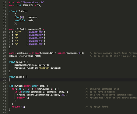

With a switch() statement you cannot cover strings but only ordinal types (i.e. numeric types).
However, I have often proposed an entirely different approach with the focus of maintainability and extensibility
struct IrCmd_t {
  char     command[8];
  uint32_t code;
const IrCmd_t commands[] =
{ { "off"    , 0x20DF10EF }
, { "1"      , 0x20DF8877 }
, { "2"      , 0x20DF48B7 }
, { "-"      , 0x20DFC03F }
, { "+"      , 0x20DF40BF }
const int cmdCount = sizeof(commands) / sizeof(commands[0]); // derive command count from "dynamic" array
int button(const char* cmd) {
  for(int i = 0; i < cmdCount; i++) {                        // traverse commands list
    if (!strcmp(commands[i].command, cmd)) {                 // do we have a match?
      irsend.sendNEC(commands[i].code, 32);                  // emit the respective command code
      return i;                                              // return the index of the found command
  return -1;                                                 // no match found
To add a new command just add another line to the array declaration and the rest is taken care of already.
Even when you stick with your if() ... else if() ... else scheme a useful habit to adopt is that you should not return just any arbitrary value but rather think of some useful value to return to get some feedback about the inner state of the called function.
That is great. Looks neat and the extensibility is a big plus. However I get many error messages. Even if I understand the basics of both the code and the error messages, it is still above my knowledge.
@wilbursmith, I believe “char[8] command;” should be “char command[8];”
Yup that’s it. The only error left after verifying had to do with cmdCount which was resolved with adding int here:
Flashed and voila! Hugely appreciated the help. The code is actually really applicable in other projects as well.
Thanks @peekay123, now I have made that mistake I previously pointed out to others :blush: (corrected above).
