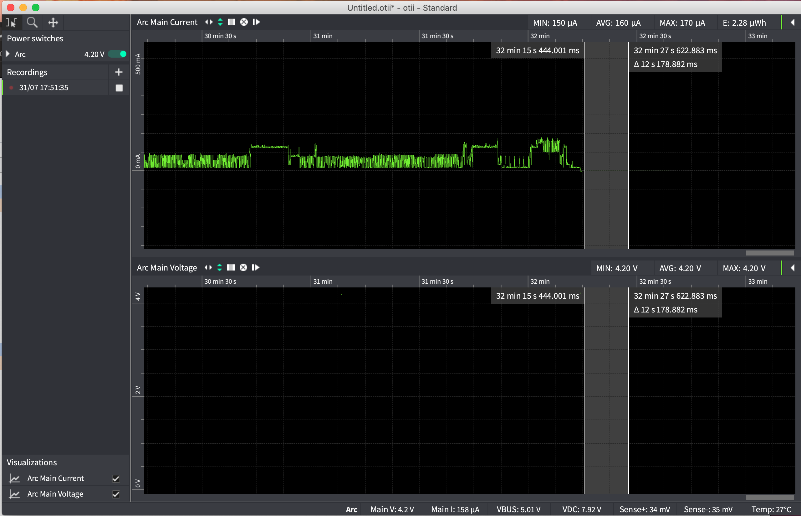

@ric_hard
I just tested with the DeviceOS 2.0 RC and this example: https://go.particle.io/shared_apps/5f203bb0e83d020008459159
160uA during STOP sleep. (Notice I’m testing with the Otii, a dedicated IoT testing device capable of accurately measuring these low currents, and I will expand on measurements and PMIC guides as soon as I have the time - it’s been a busy couple of weeks)
You can see the measurement top-right.
