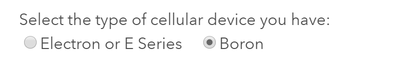

If you go to these links in the docs you will see this
Which clearly illustrates that document applies to both platforms (nvm the URL path).
If there were platform dependencies they'd be usually explicitly mentioned (e.g. see above about the Spark Core publish limit).
