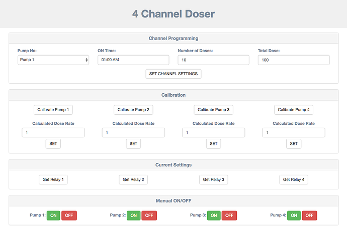

So I was able to do a trade with a friend for some help with the website programming. Here is what I came up with. I would love some feed back from you guys. I do need to incorporate a watchdog feature, but I’m going to save that for a bit so I can read up on that a bit more.
The other thing I thought about adding to this page is some sort of indicator that shows the status of the photon, online or offline, pulsing a color…I’m not too sure. Any thoughts?
What exactly do you want feedback on? If it works for you, then great :smile:
Get the initial status by doing a GET request, then subscribe to the status SSEs. Shouldn't be too hard :wink:
Thanks @Moors7, I guess I just like to get feedback from people…part of my personality.
I’ll check into the GET request. I presume I don’t need to add any additional code to my photon?
Nope, shouldn't be necessary :smile:
