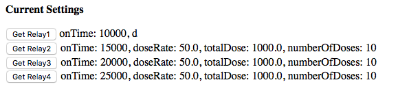

There is a bit of misunderstanding then, I thought you said I only needed it on the channels. Either way, I put it back in to play on the getRelay variables:
     retained char getRelay1[75];
     retained char getRelay2[75];
     retained char getRelay3[75];
     retained char getRelay4[75];
     retained Channel channels[4];
I then tested by inputting variables for channel 1, removed the USB plug, let it sit for about a minute, then plugged it back in, and you can see the results on the last line.
DUSTINs-MBP-2:~ dustinbetterly$ particle call doser-4 setDoseRate 1,50
1
DUSTINs-MBP-2:~ dustinbetterly$ particle call doser-4 setupChannel 1,10000,10,1000
1
DUSTINs-MBP-2:~ dustinbetterly$ particle get doser-4 getRelay1
onTime: 10000, t
So the issue only seems to reside with the first channel. Would this have anything to do with me changing the relay numbers from 0,1,2,3 to 1,2,3,4?
Probably, but it’s hard to know without seeing your whole code. However, and this is a big however; it shouldn’t be our job to troubleshoot your code. You need to do that, and you need to have the knowledge base in C and in Particle devices to do that for yourself. The way you’re pursing this project is extremely inefficient; we’re up to 206 posts on this thread, and you asked initially about this project (or a related one) back in May of 2014. It’s clear from the questions that you’re asking, and your coding attempts, that you don’t have the necessary background in C to pull this project off. Getting us to write the program through numerous questions, suggestions, hints, etc. is not going to go well; none of us knows exactly what you want, and none of us sees the whole project, so you’re likely to end up wth a mish-mash that won’t work properly. You really should step back from this project, and take whatever time it takes to learn C, and the unique characteristics of the Particle devices. I think you will find it much more rewarding, and much less frustrating to complete the project, if you learn the basics first.
