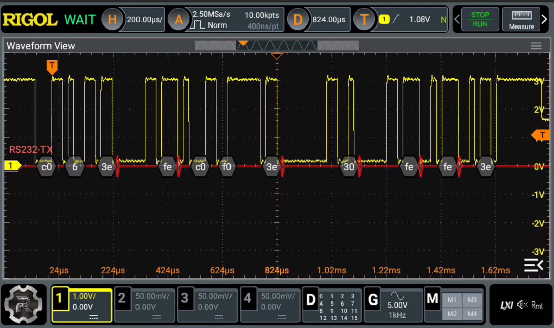

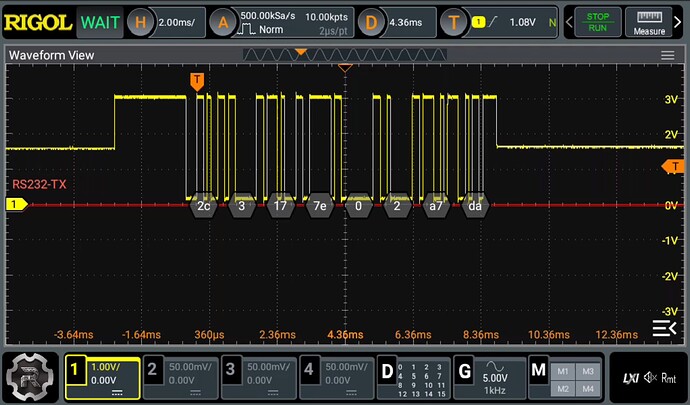

I am able to use the library to successfully send and receive data on Serial1 at various slower baud rates (i.e. baud rates lower than 115200). However, at 115200 and above, my peripheral device stops communicating with the MSOM properly. At first, I thought this must be a limitation of the peripheral device. However, after using an oscilloscope to look at the signals, I see that the request sent from the Particle MSOM is only successfully sent at baud rates below 115200. At 115200 and above, I see data coming across, but it is neither the correct data nor the same length as the correct data (though it is close to the same length).

As you can see, the 9600 baud (first photo) results in a proper MODBUS Poll request to my peripheral device. The 115200 baud attempt (second photo) does not. Even my scope can't decode it. I'm using a 10 meter cable. Other than the baud rate change, the code is the same between the two so I would expect the MODBUS requests to match when the scope decodes it. Yes, I changed the baud rate on the scope as well.
