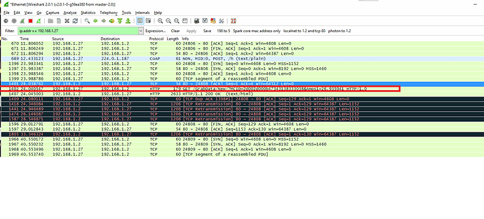

Yes you are right @timx. I caught that yesterday and added equals on all “&Amps**=**”. I’m still only seeing the first Amps1 go through on Wireshark. Is it because “request.path” requires a String and I’m concatenating doubles?
